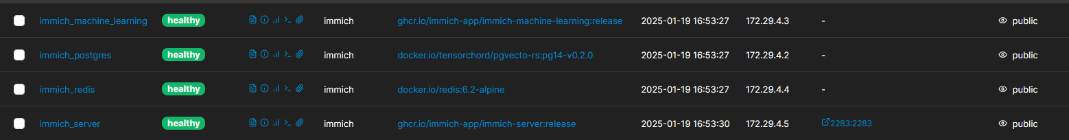

per coloro che usano Portainer vi allego quelle che sono le impostazioni (è necessaria una piccola modifica ma nulla di complesso):
services:
immich-server:
container_name: immich_server
image: ghcr.io/immich-app/immich-server:${IMMICH_VERSION:-release}
# extends:
# file: hwaccel.transcoding.yml
# service: cpu # set to one of [nvenc, quicksync, rkmpp, vaapi, vaapi-wsl] for accelerated transcoding
volumes:
# Do not edit the next line. If you want to change the media storage location on your system, edit the value of UPLOAD_LOCATION in the .env file
- ${UPLOAD_LOCATION}:/usr/src/app/upload
- /etc/localtime:/etc/localtime:ro
env_file:
- stack.env
ports:
- '2283:2283'
depends_on:
- redis
- database
restart: always
healthcheck:
disable: false
immich-machine-learning:
container_name: immich_machine_learning
# For hardware acceleration, add one of -[armnn, cuda, openvino] to the image tag.
# Example tag: ${IMMICH_VERSION:-release}-cuda
image: ghcr.io/immich-app/immich-machine-learning:${IMMICH_VERSION:-release}
# extends: # uncomment this section for hardware acceleration - see https://immich.app/docs/features/ml-har ... celeration
# file: hwaccel.ml.yml
# service: cpu # set to one of [armnn, cuda, openvino, openvino-wsl] for accelerated inference - use the `-wsl` version for WSL2 where applicable
volumes:
- model-cache:/cache
env_file:
- stack.env
restart: always
healthcheck:
disable: false
redis:
container_name: immich_redis
image: docker.io/redis:6.2-alpine@sha256:eaba718fecd1196d88533de7ba49bf903ad33664a92debb24660a922ecd9cac8
healthcheck:
test: redis-cli ping || exit 1
restart: always
database:
container_name: immich_postgres
image: docker.io/tensorchord/pgvecto-rs:pg14-v0.2.0@sha256:90724186f0a3517cf6914295b5ab410db9ce23190a2d9d0b9dd6463e3fa298f0
environment:
POSTGRES_PASSWORD: ${DB_PASSWORD}
POSTGRES_USER: ${DB_USERNAME}
POSTGRES_DB: ${DB_DATABASE_NAME}
POSTGRES_INITDB_ARGS: '--data-checksums'
volumes:
# Do not edit the next line. If you want to change the database storage location on your system, edit the value of DB_DATA_LOCATION in the .env file
- ${DB_DATA_LOCATION}:/var/lib/postgresql/data
healthcheck:
test: >-
pg_isready --dbname="$${POSTGRES_DB}" --username="$${POSTGRES_USER}" || exit 1;
Chksum="$$(psql --dbname="$${POSTGRES_DB}" --username="$${POSTGRES_USER}" --tuples-only --no-align
--command='SELECT COALESCE(SUM(checksum_failures), 0) FROM pg_stat_database')";
echo "checksum failure count is $$Chksum";
[ "$$Chksum" = '0' ] || exit 1
interval: 5m
start_interval: 30s
start_period: 5m
command: >-
postgres
-c shared_preload_libraries=vectors.so
-c 'search_path="$$user", public, vectors'
-c logging_collector=on
-c max_wal_size=2GB
-c shared_buffers=512MB
-c wal_compression=on
restart: always
volumes:
model-cache:
Per le Variabili invece ho fatto copia incolla dentro l'editor di Portainer (ovviamente adattandole)
# Dove salvo le immagini
UPLOAD_LOCATION=/share/CACHEDEV2_DATA/Immagini
# Percorso Database
DB_DATA_LOCATION=/share/CACHEDEV2_DATA/apps/immich/postgres
TZ=Europe/Rome
IMMICH_VERSION=release
DB_PASSWORD=Imposta qui la password scelta (escluso il simbolo del dollaro "$")
DB_USERNAME=postgres
DB_DATABASE_NAME=immich
In questo modo senza dover apporre ulteriori modifiche ai file viene creato il Container con tutte le dipendenze necessarie
Andando poi su
IP_HOST:2283
Parte il setup del programma
Spero possa essere utile come Guida.

Messaggi: 76
Iscritto il: 10/02/2020, 23:41
Re: Configurare Immich tramite Container Station
Messaggio da lfranceschin »
Ciao, non riesci perchè si blocca dove?
Hai seguito i passi indicati qui sopra?
Salv71
Messaggi: 5
Iscritto il: 06/05/2025, 19:15
Messaggio da Salv71 »
Mi da questo errore
Failed to create application "docker-compose". Error message: no matching manifest for linux/arm/v7 in the manifest list entries
Non uso Portainer perchè non so come installarlo su Qnap 231P.
lfranceschin
Messaggi: 76
Ah ok…
Lo script che ho incollato qui sopra si riferisce a Portainer (come avevo indicato nel messaggio) non ho esperienza purtroppo con docker composer o container station.
Sorry
Salv71
Messaggi: 5
Come faccio ad installare Portainer su Qnap 231p?
lfranceschin
Messaggi: 76
Va installato usando il reposity di MyQNAP.org... guarda youtube e ti guiderà passo passo (io ho fatto così).
Salv71
Messaggi: 5
Immich ha interrotto il supporto per ARMv7 a partire dalla versione 1.72.0, quindi non ci sono immagini ufficiali né community aggiornate per ARMv7/armhf (32-bit) e quindi non è possibile installare Immich su Qnap 231P.
Qualcuno ha soluzioni?
lfranceschin
Messaggi: 76
In questo caso o installi una versione antecedente alla 1.72.0 (con tutti i rischi del caso) oppure usando ChatGPT (come ho fatto io) gli esponi cosa vorresti fare, gli dici il modello del NAS e con lui cerchi un alternativa valida (es. Lyncee).
Queste sono le due uniche soluzioni che mi vengono in mente purtroppo.
Salv71
Messaggi: 5
Già provato con ChatGPT ma il risultato finale è sempre lo stesso; dovrei costruire manualmente un’immagine Immich per ARMv7 (armhf) ma non mi sento in grado di poterlo fare. Una versione antecedente dove potrei trovarla? Perchè parli di rischi del caso?
antony99
Messaggi: 4
Iscritto il: 18/05/2025, 17:36
Messaggio da antony99 »
ciao, sto provando ad installare Immich tramite Container station e ho eseguito tutti i passaggi come descritti nella guida con le opportune modifiche riguardanti i percorsi, ho creato il file .env sia nella cartella tmp che in quella di immich, ma quando creo l'applicazione mi dà quest'errore env file /tmp/.env not found. Non riesco proprio a capire il perchè, mi aiutate? grazie
antony99
Messaggi: 4
Finalmente ci sono riuscito. Per chi dovesse avere il mio stesso problema, la soluzione per me è stata quella di creare un docker compose che avesse al suo interno le variabili d'ambiente del file .env, e il gioco è fatto.
